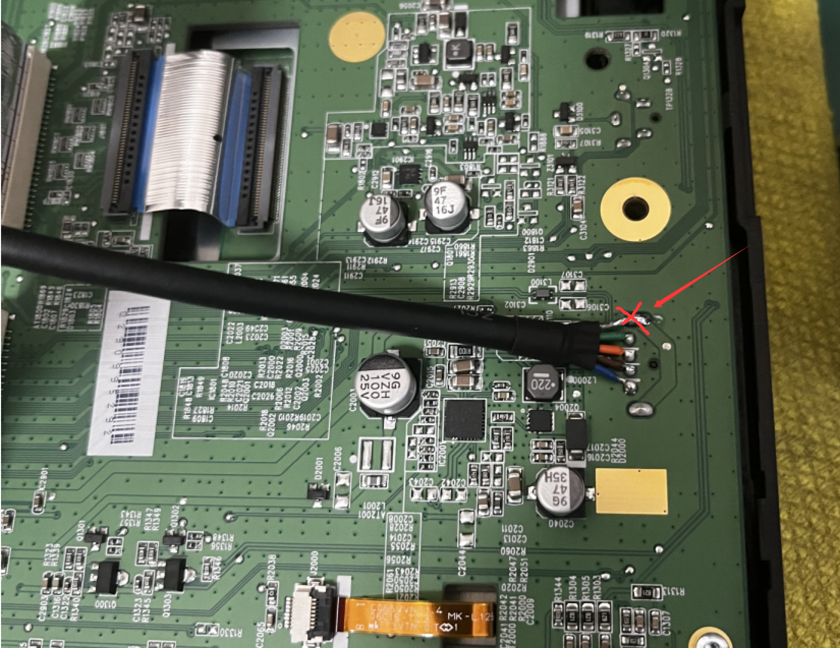

2. Due to non-standard design in some phone cables, the shielding wire is included in the impedance to ground design. I discovered this issue around late October 2025. I removed the soldering of the shielding wire on the RCD330 motherboard (removing the solder on the black wire or cutting the black wire (shield) from the 5-pin connector), leaving only the green, orange, blue, and brown wires soldered. Therefore, units ordered around the end of October with a rear USB port will not experience frequent disconnections due to this issue.

Quote from Shawn Hale on May 1, 2026, 5:04 pmHi Ddren, my 330 had wires soldered directly to the pins. I was able to cut the black wire once disassembled by removing the adhesive material from the wires and board.
I installed the unit back in the car and the behavior is the same. The only difference is I was able to use the front USB with CarPlay for an extended amount of time. I cannot get it to reconnect through the front again though.
If I cut all the wires to the rear USB port, will the front USB port function normally?
My phone and cables work fine with CarPlay in other vehicles with no issues. Thanks.

Quote from mbyk on June 17, 2026, 12:08 pmTried the fix of disconnecting the black wire. Still having the same issues.
Anyone find a fix?

Quote from wayned87 on June 17, 2026, 11:08 pmThe only fix I was able to find is to remove the connection on the rear of the radio.
You have to open up the radio and snip/remove the 5 wires that are shown/addressed in post #11 above. This removes the rear connection completely, but it works. I have been using the front usb port for a few months now, and I have not had any problems.
Not what I wanted to do, but its a lot better than fighting the rear connection.

Quote from bajones9181@gmail.com on August 17, 2026, 4:58 pmHaving same issues here and cannot get it to work despite snipping the black wire.
So if I cut all 5 wires does the front port start working for data connection? Currently my front port can ONLY charge.
Quote from wayned87 on August 17, 2026, 5:03 pmI ended up cutting all wires to the board inside and the front port now works for Apple CarPlay. I don’t have Android Auto.
