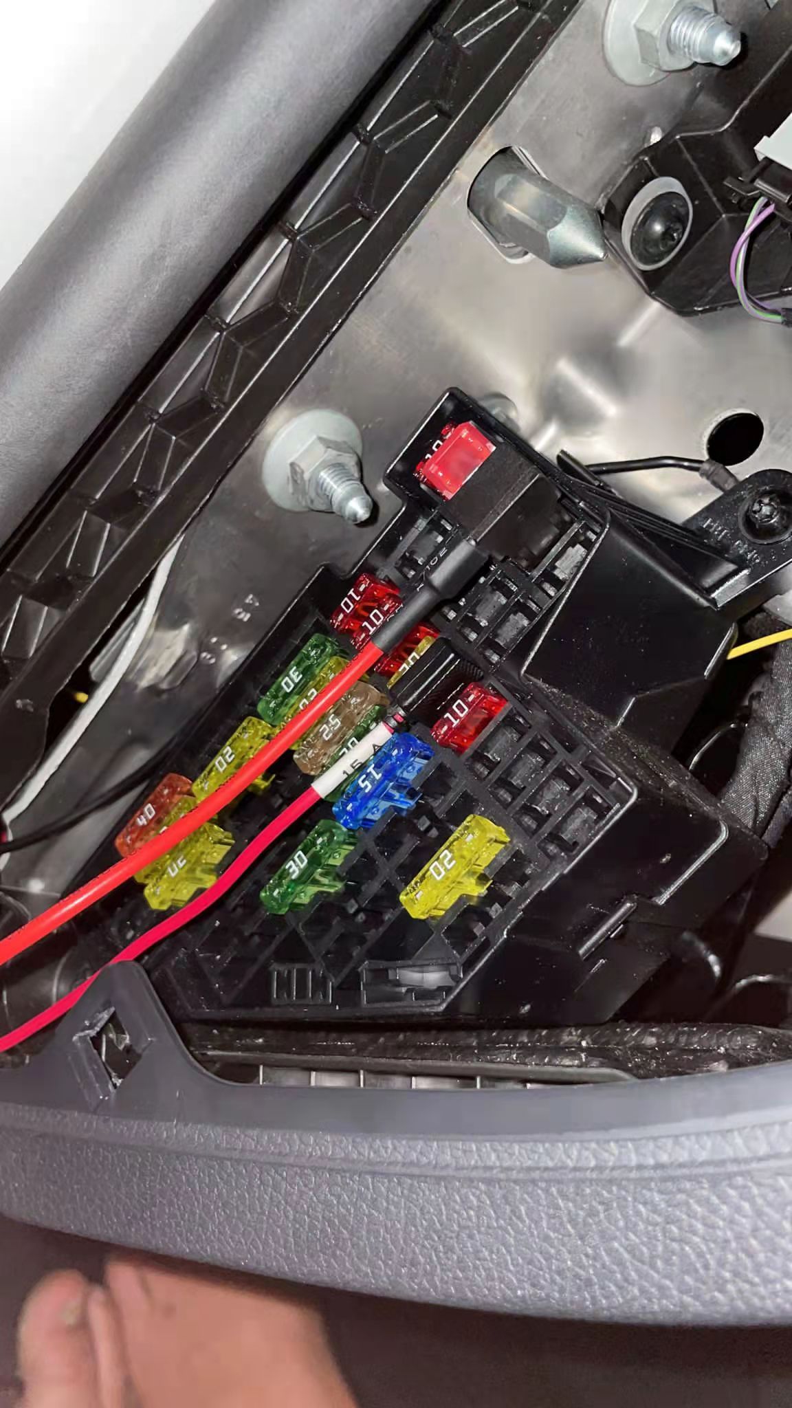

- Verify that you connected to a real ACC 12V source
On the Golf Mk5, the proper ACC source is usually fuse position #5 or #6 in the fuse box.
Even if those fuse positions are already occupied, that is not a problem.
You should:
- remove the original fuse
- insert it into a fuse tap / fuse shared adapter
- then install the fuse tap back into the original fuse position
A lot of shutdown issues come from using the wrong fuse position that does not provide proper ignition-switched ACC behavior.

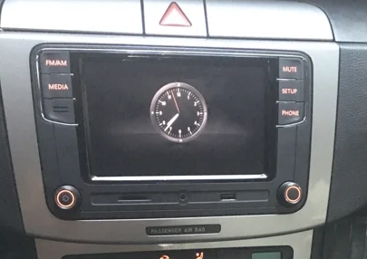

- Press and hold the power button on the RCD330
- Watch the display carefully
If you see the circular clock image on the screen, that usually means communication between the RCD330 and the CAN Gateway is working normally.
If the clock image does NOT appear correctly, then there is likely a CANBUS communication issue.

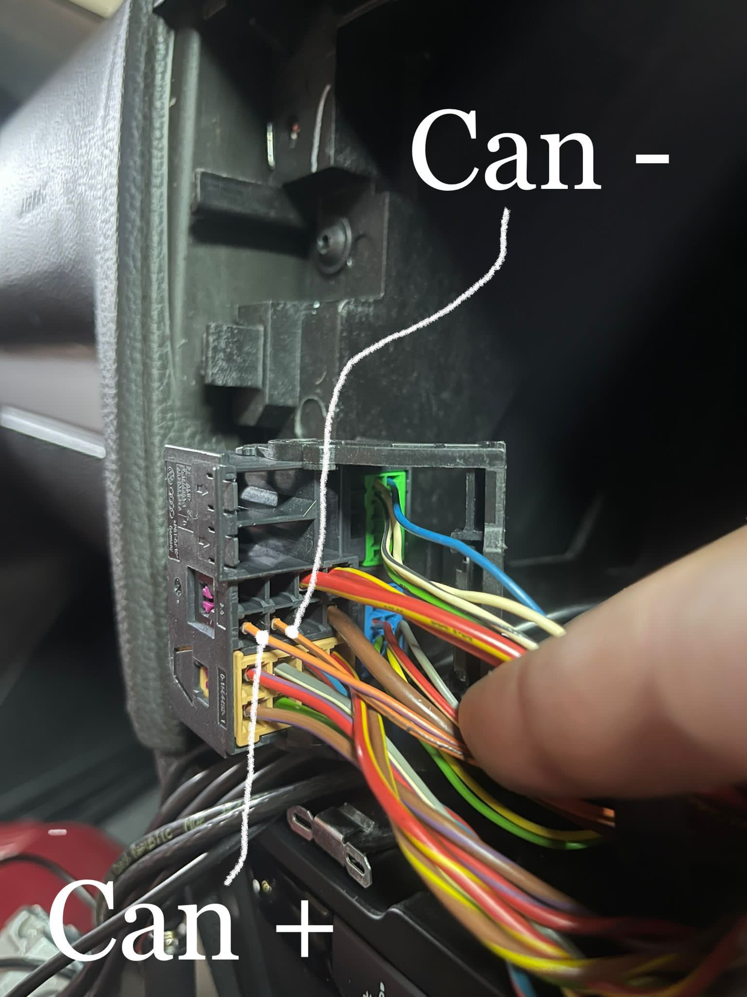

In that case, carefully inspect:
- CANBUS High (CAN+)
- CANBUS Low (CAN-)
- Quadlock connector pin integrity
- adapter harness quality
Even a partially loose CAN connection can cause abnormal sleep behavior.
You should:
- CANBUS Low (CAN-)

I verified that the 12V ACC wire is connected to fuse position #5 exactly as in the picture above.
However the clock test seems to have failed - I could not get the clock displayed as described although some times I've seen the round clock when switching the unit on.
